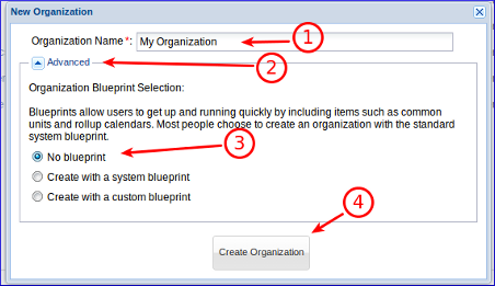

Save Organization
1. Enter a name for the new organization. Any name is allowed.
2. Expand the Advanced section.
3. Selct No blueprint. This will create an empty organization with no existing units, cycles, or other entities so that basic modeling can be learned. If you were to select the system standard blueprint (the default), you could skip the manual creation of units, cycles, and rollup calendars.
4. Click Create Organization.

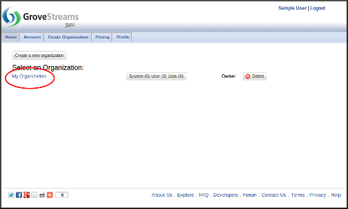

Select Organization
Select your new organization by clicking on its name.
You will be directed to the organization's observation studio page.

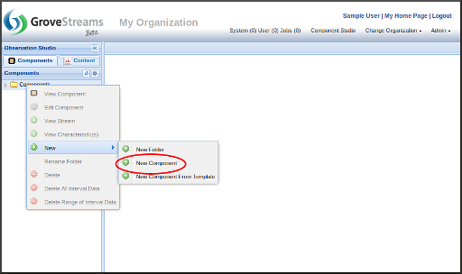

Create Component
Right click on the Components folder and select New - Component

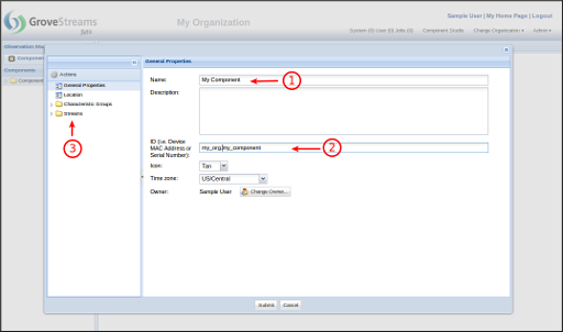

Component General Information
1. Enter a name for the component. It can be any name.
2. Set the ID to: "myOrg.myComponent". This will be used later in the feed upload code - step 5. You can change the ID, but it must match the ID used in the code below.
3. Right click on the Streams folder and select Add - Stream - Interval Stream.

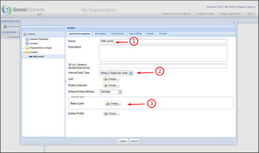

Stream General Information
1. Enter a name for the new stream. It can be any name.
2. Select Data Type as string
3. Select a base cycle for the stream by clicking the Change... button

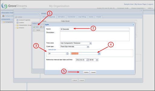

Create Cycle
1. Click the New button to create a new cycle
2. Enter "10 Seconds" for the new cycle name
3. Enter "10" for the cycle size
4. Choose Seconds for the cycle size type
5. Save the new cycle

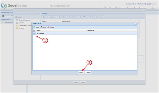

Select Cycle
1. Select the newly created cycle
2. Click the Select button

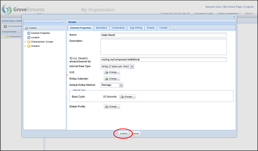

Save Stream
Click the Save button to save the newly created component and stream.

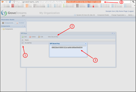

Step 4: Create an API Secret Key
Create API Key
1. Click the API Keys button
2. Click the Add button 2. Enter a name for the new API Key. It can be any name.
4. Click the Add Type button and select component/*/feed
5. Ensure PUT is only selected
6. Click Save
This API key will give your GroveStreams API clients rights to upload feed data for all streams for this organization. This key could be restricted to certain IP addresses and/or to a specific stream, but for this example we will create a key that can be used for all feeds for this organization.
Copy Secret Key
1. Select the newly created key
2. Click the View Secret Key button
3. You can select the secret key id and copy it to the clipboard (Ctrl-c) and paste it (Ctrl-v) into your feed code (Step 5 below)

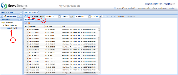

Step 7: See your results
Stream View
1. Double click the Hello World stream
2. Click the Refresh button to see the latest intervals
Congratulations! You have created your first feeder!
