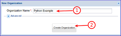

1. Enter a name for the new organization. It can be any name.
2. Click Create Organization.

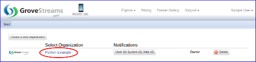

1. Enter your new organization by clicking on its name.

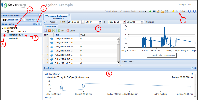

Within your GroveStreams organization:
1. The notification button will indicate if you have any notifications. Some notifications report errors. Check for any notifications that may contain any upload errors.
2. Select the Components folder.
3. Click the Refresh button.
4. Your new component will appear under the Components folder. Expand it to view its streams.
5. Select a Stream.
6. Your latest measurements will appear within the Quick View panel. The Quick View panel will display No Data if no measurements have been uploaded.
7. Double click a stream to explore or edit historical values.
