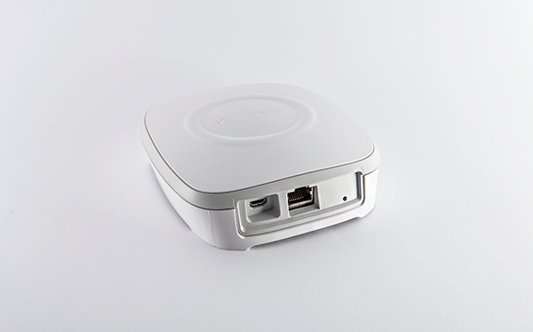

1. SmartThings Hub

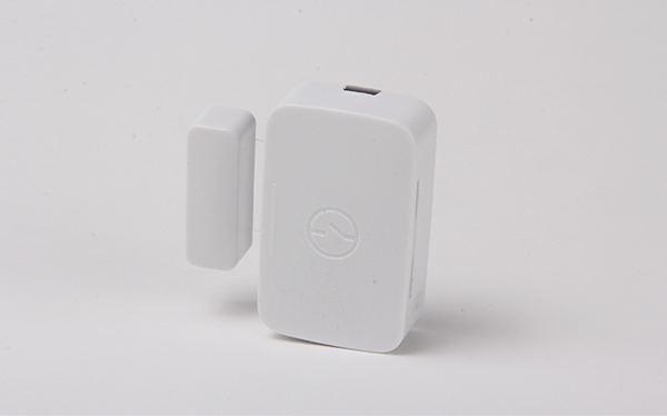

2. SmartSense Open/Closed Sensor

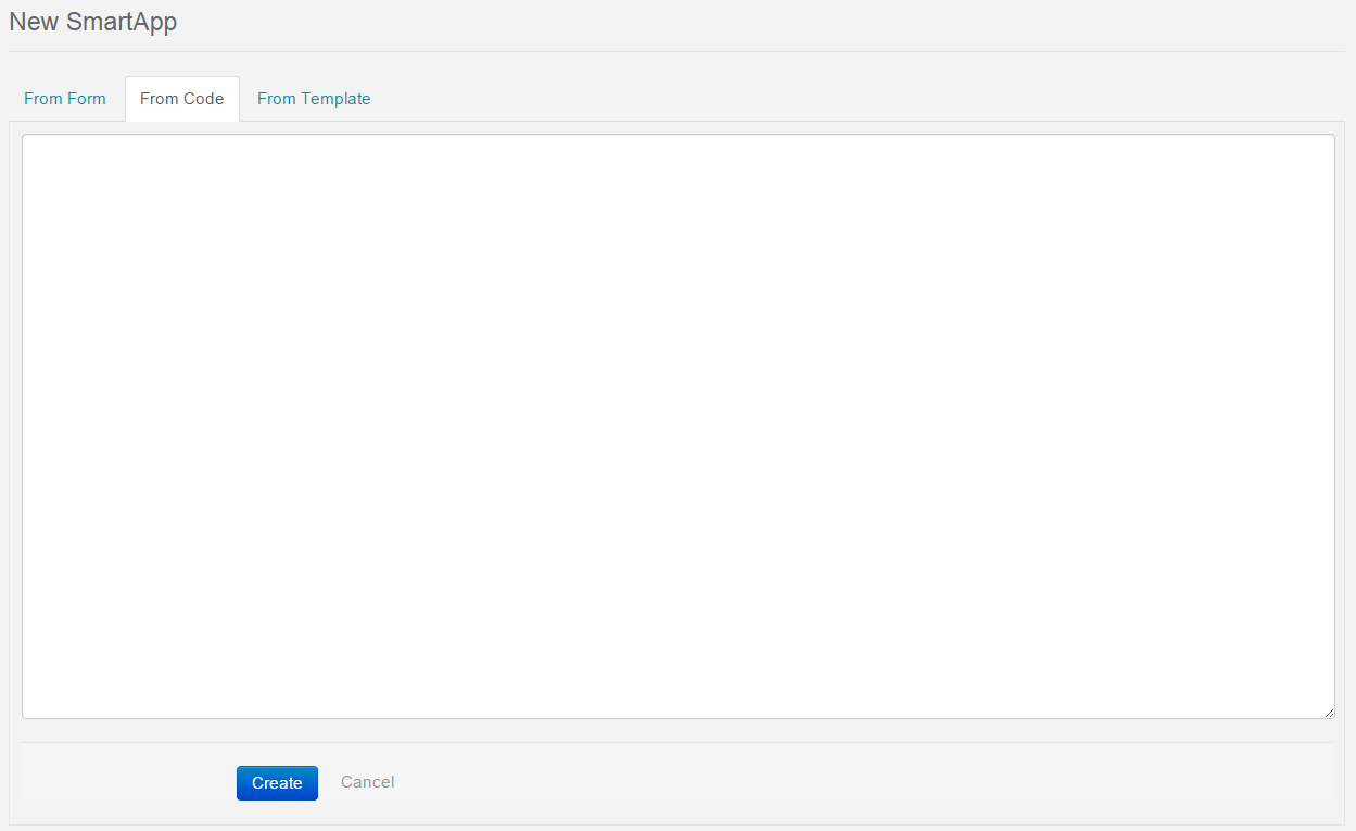

- Select the My SmartApps tab and click the New SmartApp button:
- Select the From Code tab so that the large text box is shown:
- Paste the following code into the large text box above and click the Create button:
How to Copy(Can't see the code below? It can also be found here: pastebin.com/1iKLsfpw)
Select all of the code below and copy it to the clipboard (Ctrl-c). Click in the box above and paste the code (Ctrl-v). Remove the first line "Data provided by Pastebin.com - Download Raw - See Original" from the top of the editor.
Or
Click the Download Raw link below, select all of the code and copy it to the clipboard (Ctrl-c). Click in the box above and paste the code (Ctrl-v).

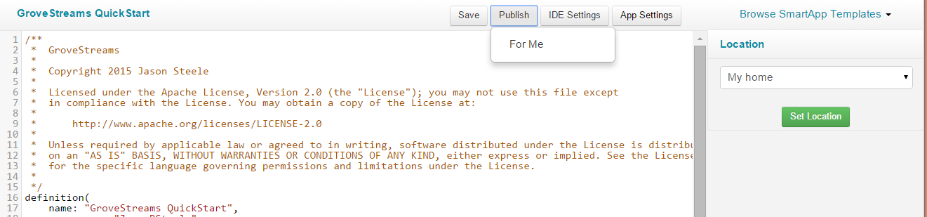

- We will now publish the created app so that you can select it within
the SmartThings mobile app. Click the Save button first, then click the Publish
button and select For Me:
You Should See:

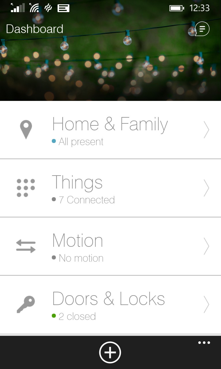

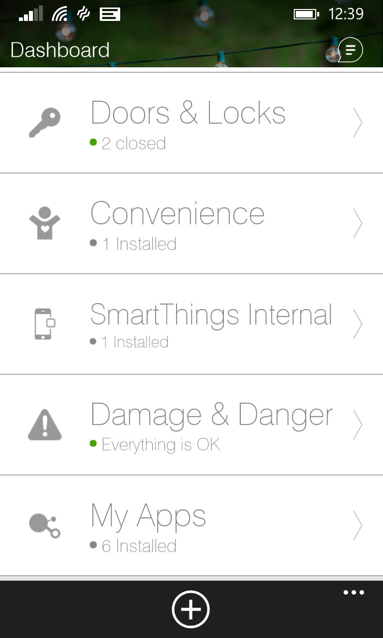

- Launch the SmartThings mobile app on your smart phone and tap the Add button in the Dashboard:

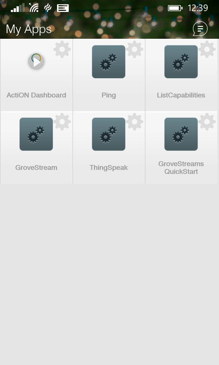

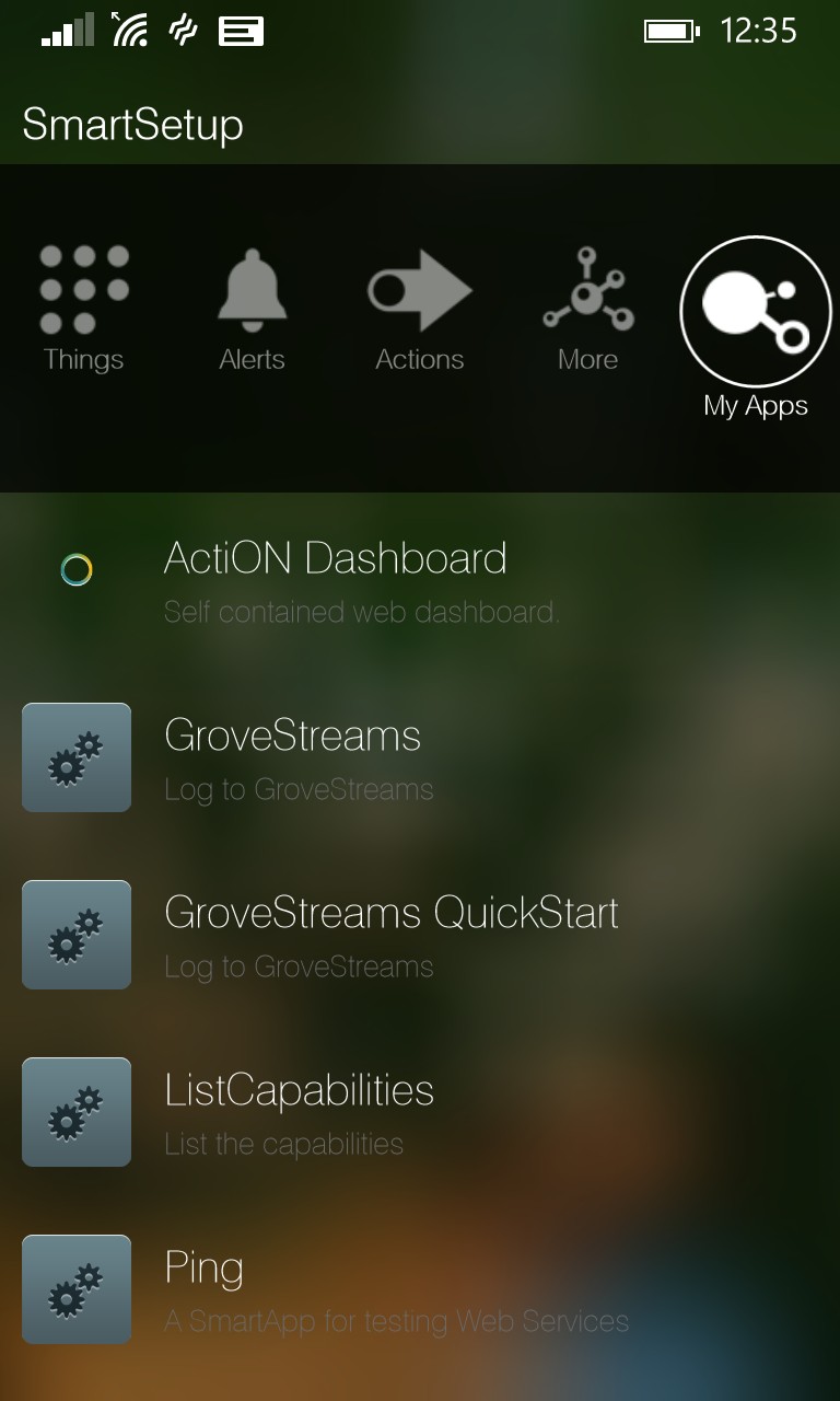

- Select My Apps. You should see the GroveStreams QuickStart app listed. If you do
not, then try force closing the app and restarting it.
If this also fails, then try re-saving and publishing the app in the SmartThings web site.

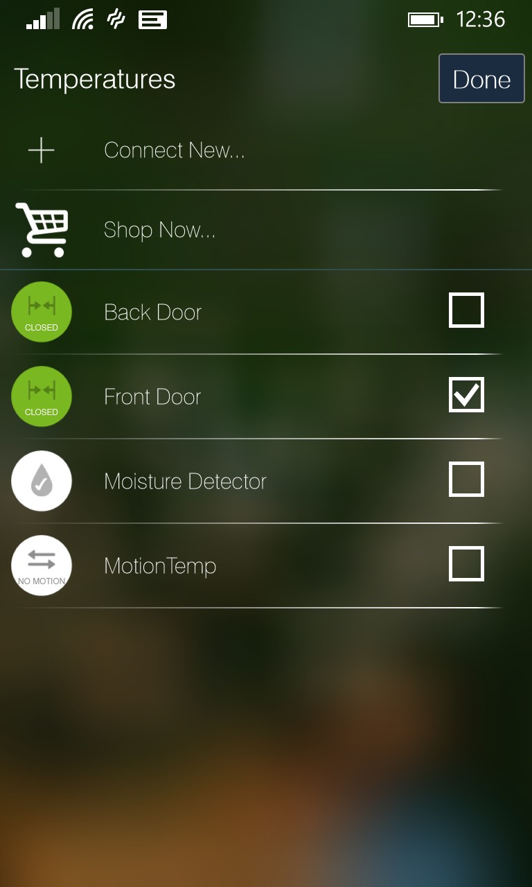

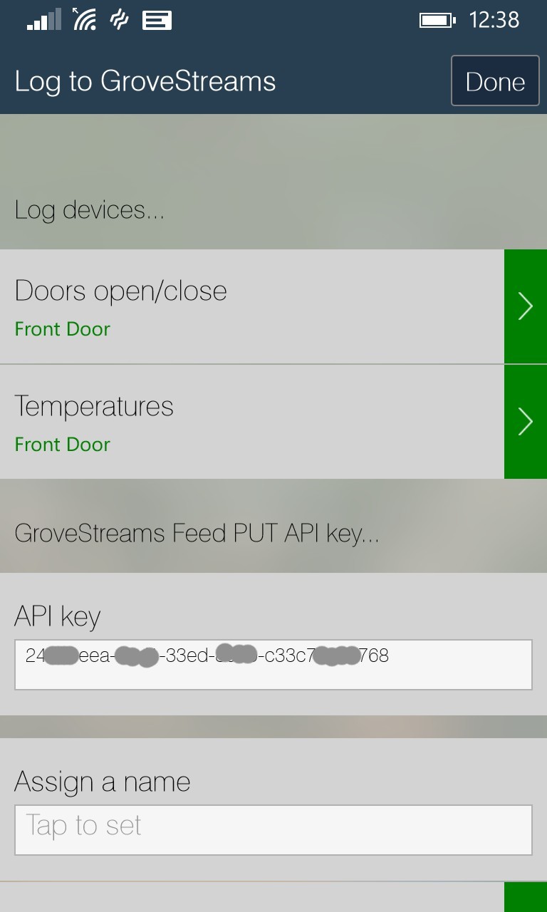

- After selecting the app, you will be taken through some screens to configure it.

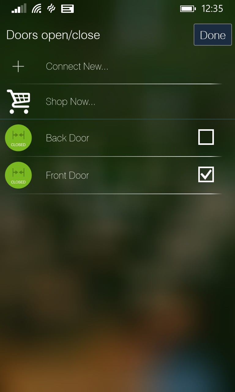

Tap Doors open/close and select the device.
Then do the same for Temperatures. Finally, paste the API key you
copied from your email earlier and tap Done.

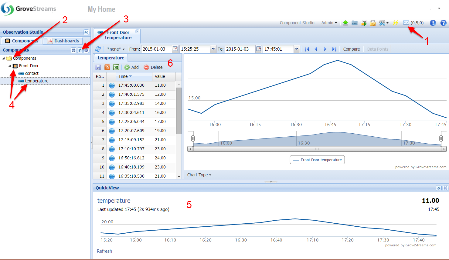

- Within your GroveStreams organization:
- The notification button will indicate if you have any notifications. Some notifications report errors. Check for any notifications that may contain any upload errors.
- Select the Components folder.
- Click the Refresh button.
- Your new component will appear under the Components folder. Select and double-click a stream.
- The stream's latest measurements will appear within the Quick View panel. The Quick View panel will display No Data if no measurements have been uploaded.
- Stream Viewer. Explore a stream's historical measurements and its latest measurements. Select different cycles to zoom in or out.
