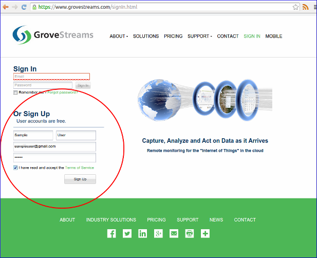

Open a browser and navigate to the GroveStreams registration page and sign up:

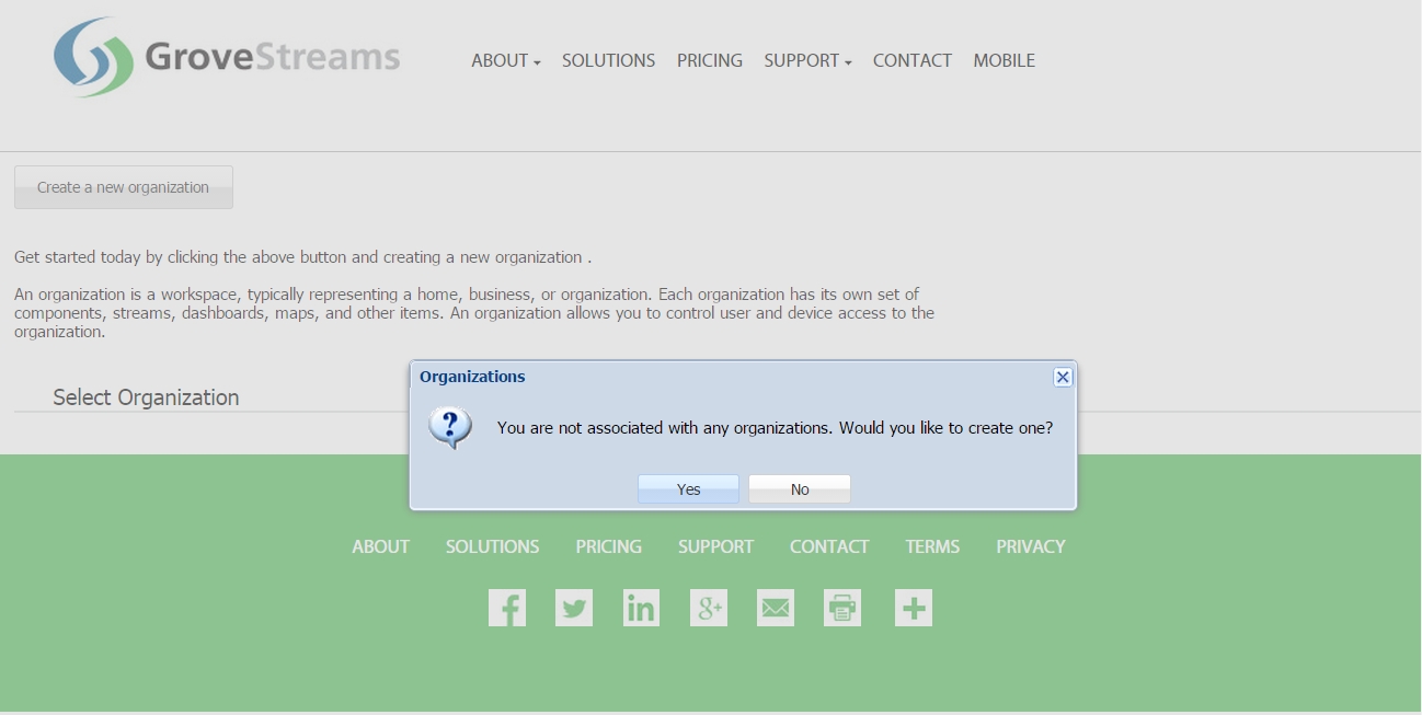

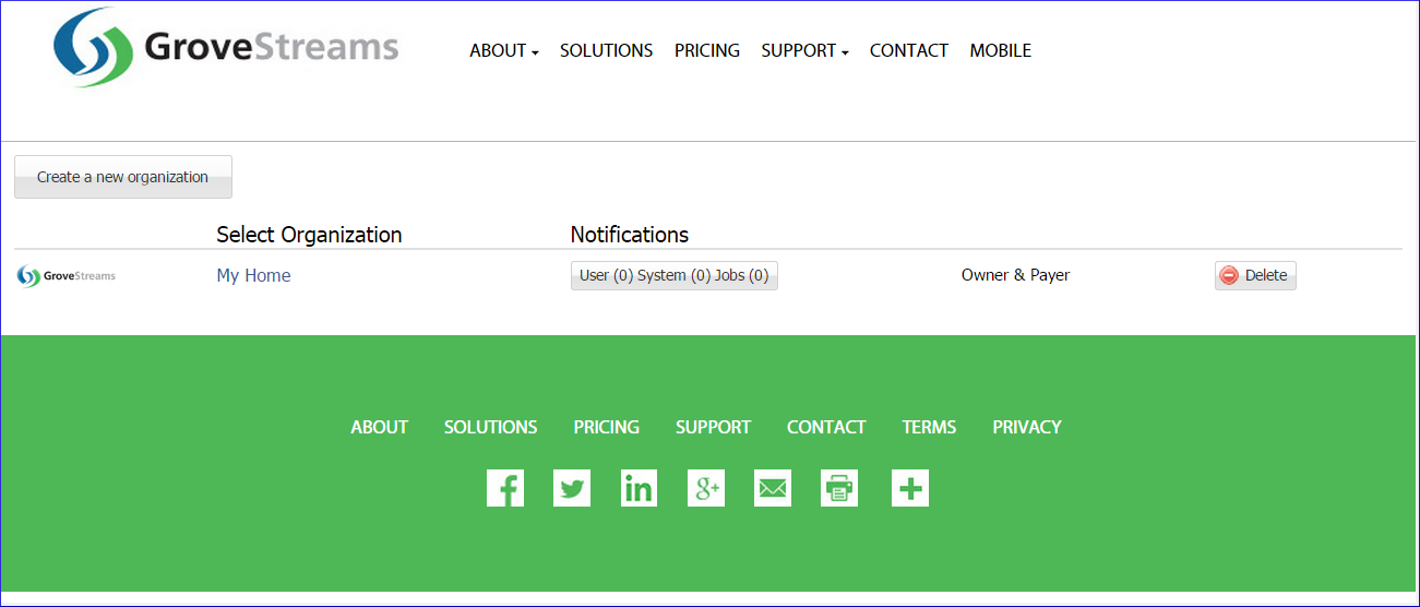

You will be prompted to create an organization. Select Yes:
What's an Organization?
An organization is a Workspace, typically representing a home, business, or organization. Each organization has its own set of components, streams, dashboards, maps, and other items. An organization allows you to control user and device access to the organization. You are automatically the "owner" and given full access rights when you create an organization. Other users may invite you to their organizations with rights they give you. All of the organizations, you "own" or are a member of, will appear in your GroveStreams start page (the first page that appears when you sign in).

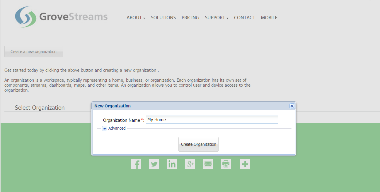

Enter a name for the new organization. It can be any name. Click Create Organization:
Enter your new organization by clicking on its name:

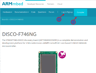

1. Create a user account at mbed here.
2. Click on the Compiler button after the account has been created and confirmed.

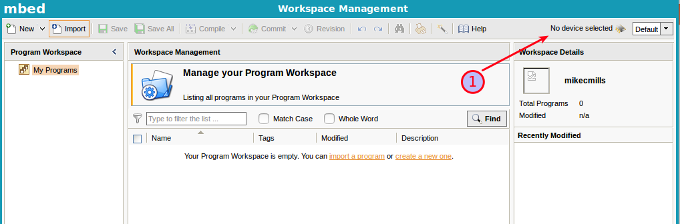

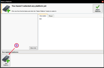

Set the board within the compiler:
1. Click No device is selected

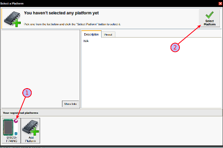

1. Click Add Platform
1. Find and click on the DISCO-F746NG
1. Select DISCO-F746NG
2. Click "Select Platform"

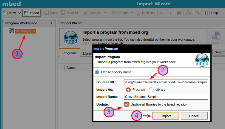

The mbed online compiler allows projects to be published for anyone to use. We've published this example. It can be inserted into your IDE:
1. Right click on Projects and select Import Program - From URL
2. Source URL: https://developer.mbed.org/teams/GroveStreams/code/GroveStreams-Simple/
3. Enable Update
4. Click Import

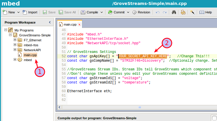

1. Double click main.cpp

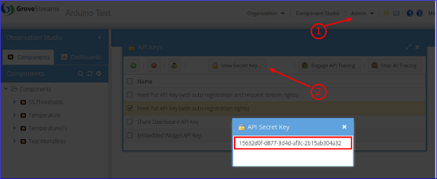

2. Set the gsApiKey variable in your sketch to match your GroveStreams organization Secret API Key.
To find your Secret API Key:
1. Select the Admin - API Keys menu option and choose the Feed Put API Key (with auto-registration and request stream rights) key
2. Click View Secret Key
3. Select and copy the API Secret Key to the clipboard (Ctrl-c) and paste it into your sketch (Ctrl-v) replacing the existing gsApiKey value.

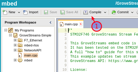

1. Click Compile

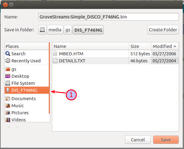

1. Save the compiled image onto the device by selecting the USB drive. The image may be saved automatically into your browser's download directory if you are not prompted for a save location.
The newly compiled image is automatically installed and ran by the board when it is saved onto the board's root directory.

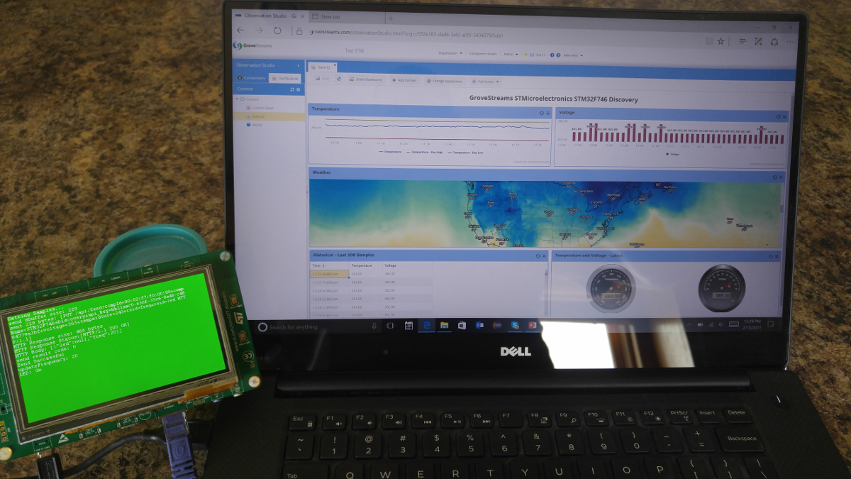

Congratulations! You have successfully pushed data from and STMicroelectronics board that pushes measurements into GroveStreams.

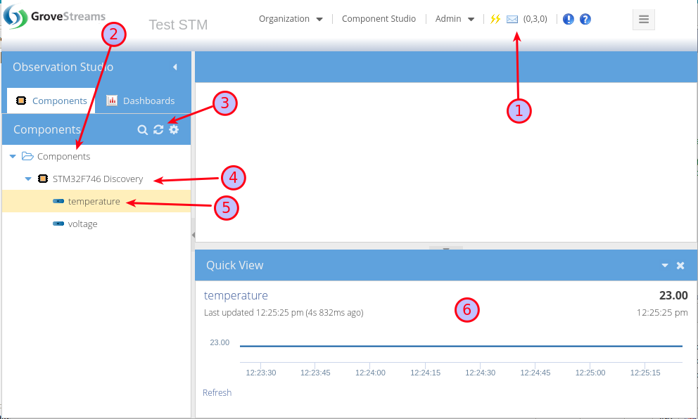

Your data will arrive within 20 seconds as a data stream under a newly created component in Observation Studio:
1. The notification button will indicate if you have any notifications. Some notifications report errors. Check for any notifications that may contain any upload errors.
2. Select the Components folder.
3. Click the Refresh button.
4. Your new component will appear under the Components folder.
5. Select a Stream
6. Your latest measurements will appear within the Quick View panel. The Quick View panel will display No Data if no measurements have been uploaded.
Double click a stream to explore or edit historical values. Click on the Dashboards tab to create dashboards and maps. Right click on the component and choose Edit Component to set your component's location, add stream units, create events with notifications, and change other properties. Keep exploring and learning!
